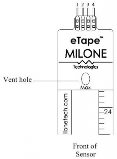

Here is the front picture of the sensor:

From the datasheet, Rsense is pin 2 & 3 while Rref is pin 1 & 4. From Arduino, i connect +5V to pin 1 of the sensor, analog A0 to pin 2, and GND to pin 3. Am i doing it right? Because it's not working. Please, any help would be much appreciated!

BTW, you should refer to the diagram for microcontroller in the datasheet, the right most diagram. The connection that you did, until when also cannot get any reading. If you study the datasheet thoroughly, Rsense work independently from Rref. Basically you can ignore Rref, on the other hand, you can also utilize it :)
Let try this: Connect 5V from arduino to pin 1, connect pin 4 to pin 3 and to A0 of arduino, connect pin 2 to GND of Arduino. Let's see the result.

robosang WROTE:Let try this: Connect 5V from arduino to pin 1, connect pin 4 to pin 3 and to A0 of arduino, connect pin 2 to GND of Arduino. Let's see the result.
Man u rocks! It WORKS! :D Thank you so much!
