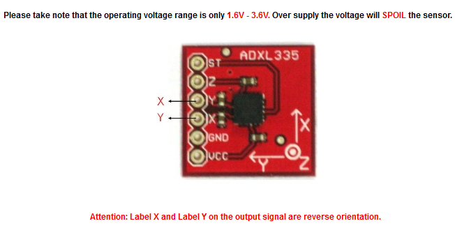

Did you see this: viewtopic.php?f=24&t=11205
And you can just use sk40c port for adxl335 But, make sure the supply voltage is 3.3V. You need a regulator to convert your 5V to 3.3V.
Since IDG500 is operating at 5V you can just use sk40c to supply the voltage.

ADXL335: X, Y, Z -> analog pin 1, 2 , 3 of sk40c
IDG500: XOUT, YOUT -> analog pin 4, 5 of sk40c
