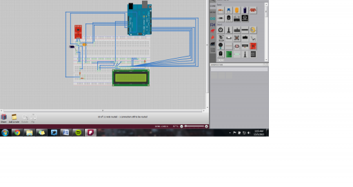

Here is my sample code attach to the arduino and also my circuit connection.
/* This sketch describes how to connect a ACS712 Current Sense Carrier (http://www.pololu.com/catalog/product/1186) to the Arduino, and read current flowing through the sensor.
Vcc on carrier board to Arduino +5v
GND on carrier board to Arduino GND
OUT on carrier board to Arduino A0
Insert the power lugs into the loads positive lead circuit, arrow on carrier board points to load, other lug connects to power supply positive */
// include the library code:
#include <LiquidCrystal.h>
int batMonPin = A4;    // input pin for the voltage divider
int batVal = 0;       // variable for the A/D value
float pinVoltage = 0; // variable to hold the calculated voltage
float batteryVoltage = 0;
float ratio = 2.1; // Change this to match the MEASURED ration of the circuit, 10k R1 and 5.1k R2
int analogInPin = A0;  // Analog input pin that the carrier board OUT is connected to
int sensorValue = 0;        // value read from the carrier board
int outputValue = 0;        // output in milliamps
LiquidCrystal lcd(12, 11, 5, 4, 3, 2);
void setup() { // initialize serial communications at 9600 bps:
 // set up the LCD's number of columns and rows:
  // initialize the serial communications:
   lcd.begin(16, 2);}
// read the analog in value:
sensorValue = analogRead(analogInPin);
// convert to milli amps
outputValue = (((long)sensorValue * 5000 / 1024) - 500 )/ 133;
 batVal = analogRead(batMonPin);    // read the voltage on the divider
  pinVoltage = batVal * 0.00488;       //  Calculate the voltage on the A/D pin
                                    //  A reading of 1 for the A/D = 0.0048mV
                                    //  if we multiply the A/D reading by 0.00488 then
                                    //  we get the voltage on the pin.
  batteryVoltage = pinVoltage * ratio*10;    //  Use the ratio calculated for the voltage divider
                                          //  to calculate the battery voltage
 //* sensor outputs about 100 at rest. Analog read produces a value of 0-1023, equating to 0v to 5v. "((long)sensorValue * 5000 / 1024)" is the voltage on the sensor's output in millivolts. There's a 500mv offset to subtract. The unit produces 133mv per amp of current.*/
// when characters arrive over the serial port...
 Serial.print("sensor = " );
Serial.print(sensorValue);
Serial.print("\t Current (ma) = ");
Serial.println(outputValue);
  lcd.setCursor(0,0);
    lcd.print(batteryVoltage);
    lcd.print(" V ");
    lcd.print(outputValue);
    lcd.print(" mA ");
 // wait 10 milliseconds before the next loop
 // for the analog-to-digital converter to settle // after the last reading:
 delay(1000); }

Postby robosang » Mon May 13, 2013 9:20 pm
Let me ask some questions so you know what you are getting.
What is the voltage output when there is 1A current through the sensor?
How do you change the current when you use power supply?
How much current do you expect the solar panel?

Re: ACS 712 Current Sensor Breakout Board
Postby atuk5259 » Fri May 24, 2013 11:22 am
hi,
Base on 5A sensor spec :
(Supply Voltage 5V)
0Amp : 2.5V
Voltage will be increase 185mV/A
its mean for 1A current will be 2.5v + 0.185v = 2.685
and 5A = 2.5v+(0.185*5) = 4.25v
thanks
atuk5259@gmail.com
atuk5259
Posts: 11
Joined: Mon Apr 22, 2013 1:48 pm
Postby robosang » Fri May 24, 2013 10:08 pm
Yes, atuk5259 is right.
atuk5259 WROTE:Base on 5A sensor spec :
(Supply Voltage 5V)
0Amp : 2.5V
1st thing 1st, you must have current through the sensor, you adjust voltage on power supply for what? You are measuring current :) You turn the current knob will not increase current because your connection is not correct. 1A can only produce 185mV, that is 0.1V. so your solar panel can only generate mA, what do you expect the voltage to change?

Postby robosang » Mon May 27, 2013 9:30 pm
It depends. What is the sensitivity of your ADC? What will be the resolution if 0.1A through the sensor? If your ADC can detect that changes, you can still use it.
