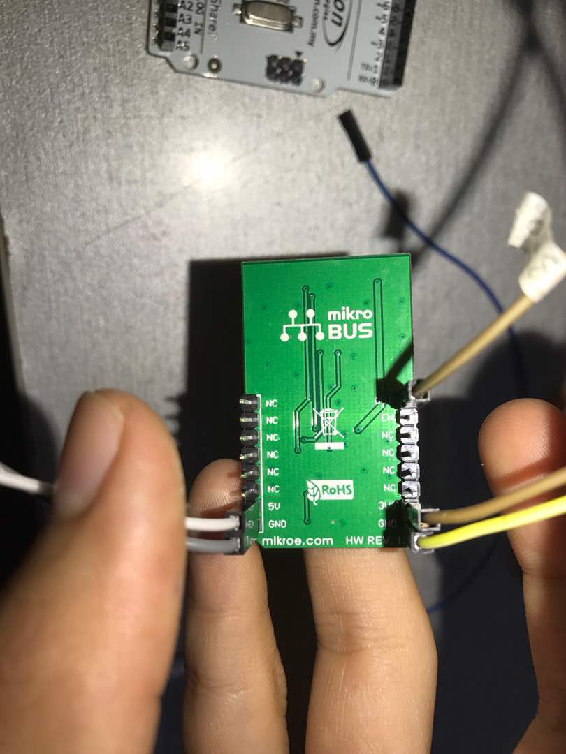

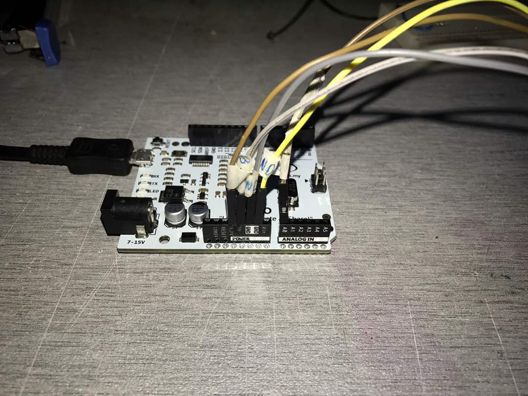

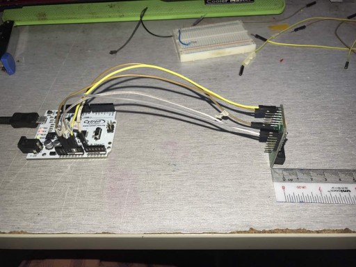

Connection the sensor to the Arduino:
sensor - arduino
VCC - 5V
Gnd - GND
OUT - A0
Briefing:
This program has the sole purpose of measuring distances with the Infra-Red sensor.
It uses a previous calculated regression to convert analogRead values into distance values.
