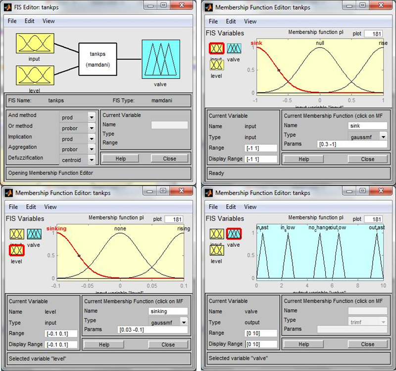

Suppose that i've created the following Fuzzy control in Matlab, where the output will be the number of time in seconds.
And from googling so many time, i found this useful website that can translate the Fuzzy control from Matlab to C code that is useable to Arduino. Here's the link: http://makeproto.com/blog/?p=35
I name my Matlab file as tankps.fis. Here's the translated code in C:

Well now my problem is, i don't know how to access the inputs and output of the translated code. The instruction given (on the link) in step 5 is to create an array of inputs and an array of outputs. I don't understand the step 6, which it says:
Call the system function with a pointer to the inputs and a pointer to the outputs (the function will have the same name as your .FIS file).
HELP please! =(
