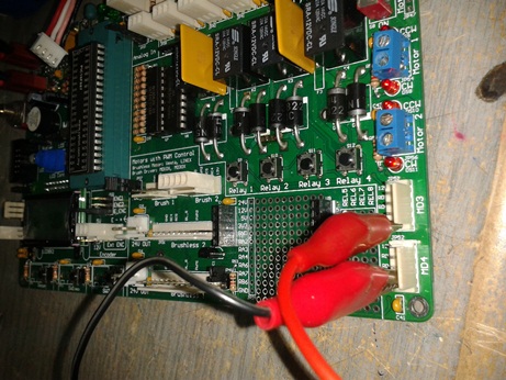

Postby dadieaxmal » Tue Mar 06, 2012 3:48 pm
con 1.jpg (81.83 KiB) Viewed 5617 times
robosang WROTE:This is where a photo of whole hardware will help :mrgreen:

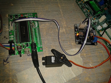

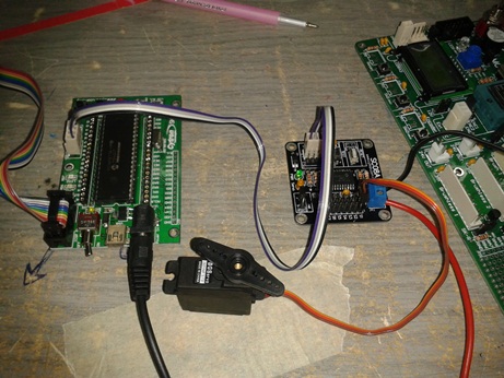

Re: HOW TO CONTROL SC08A WITH MC40SE
Postby dadieaxmal » Tue Mar 06, 2012 3:55 pm
hyng WROTE:There is a test button on SC08A. Can you please try to press that button and see if the servo is turning not? Anyway, if you can post some photos of your connection here would be helpful too.
heres another pic....
con 2.jpg (80.38 KiB) Viewed 5617 times

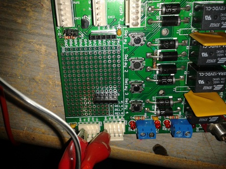

Postby dadieaxmal » Tue Mar 06, 2012 3:58 pm
sc08a power supply came from mc40se....
con 4.jpg (91.01 KiB) Viewed 5617 times

Postby robosang » Tue Mar 06, 2012 6:37 pm
1st, are you sure the crocodile clip at bigger board is not shorting the adjacent pin? Seem to be the possibility to get short is very high, why you don you use a proper wiring? I have been using Female to Male Jumpers from Cytron, is very convenient, and safe :mrgreen:
As hyng suggested, there is a test button on SC08A, you should power up (with proper supply) and press that button. I think their user's manual show the basic setup right?
i already press the test button on sc08a butthe servo did not turning at all...

[quote="robosang"]1st, are you sure the crocodile clip at bigger board is not shorting the adjacent pin? Seem to be the possibility to get short is very high, why you don you use a proper wiring? I have been using Female to Male Jumpers from Cytron, is very convenient, and safe :mrgreen:
the crocodile clip is ok i just want to show my connection that's why i remove the insulation for more clear picture.... ;)
Postby hyng » Wed Mar 07, 2012 10:25 am
Did the Green LED on SC08A lit ON? it is the indicator for 5V supply for MCU on SC08A. Both LED on SC08A must be turn ON.
If you have a multimeter, please measure the voltage of SC08A and also servo power.
hyng
Posts: 292
Joined: Thu Apr 16, 2009 11:35 am
Postby dadieaxmal » Wed Mar 07, 2012 1:57 pm
hyng WROTE:Did the Green LED on SC08A lit ON? it is the indicator for 5V supply for MCU on SC08A. Both LED on SC08A must be turn ON.
Both Green and Orange LED is ON.....
